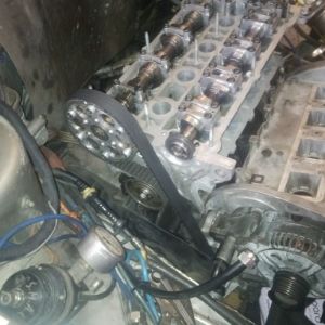

Postby Rudster on Wed Dec 04, 2013 8:30 am
So bit of an update,
I was busy building a 2.2 strocker 20v motor using the tdi ahl block and the AEB big port head. But then ran into issues when the engineers messed up the bore. So decided just to use my current 2e 2.1 sub assembly with the 20v head. I started about 2 weeks ago and got quite far with the build. Had to build a new Turbo branch, new downpipe, new intake,change oil pump to 8v,add 2e distributor,modify water pipes,pocket pistons ect..
So the mocking up is completed. Sent the parts away for welding. Hopefully get it back in time before pretty polish closes.
Then its the last bit of cleaning and assembling.
